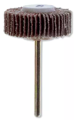

This bit was my friend this weekend (a 3/8" 80-grit flap wheel). I was able to get up close and accurate sanding between my fiberglass work and plexiglass without any worries over taking too much material away.
