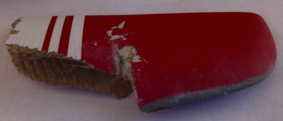

  3. Ha. Picture's worth (in this case) 75 words.
    Interestingly, this (remove the section of the wing aft of the dotted red line):
    is what the TE of my right wing looked like after the prop hit it on its way to Joshua Tree NP 9500 ft. below us in 2006. The prop took off the TE outboard of the aileron, plus a little bit of the TE of the aileron over the last 4 - 6 inches. Plus 2/3 of the lower winglet. Left me with this:
    souvenir, stuck in what was left of the lower winglet.
    While I was mostly concentrating on other stuff at that point, I did not notice any substantial difference in the flight characteristics of the airplane on the way to the landing at Desert Center.
    When Mike Melvill flew me out to pick the plane up a few days later with a new prop and extension, as well as a bunch of AL tape, we taped up the TE of the wing to close out the exposed foam. It's called speed tape, right? He chased me home in the company Duchess, and I never went faster than 120 KIAS. Once again, there was no discernible difference in flight characteristics on the way home. After the flight, we ruminated on why anyone puts the last few inches of wing on the wing if it doesn't make any damn difference to how the airplane flies. But I fixed it back to the plans design anyway, not being an aerodynamicist :-).
    • Like 1
