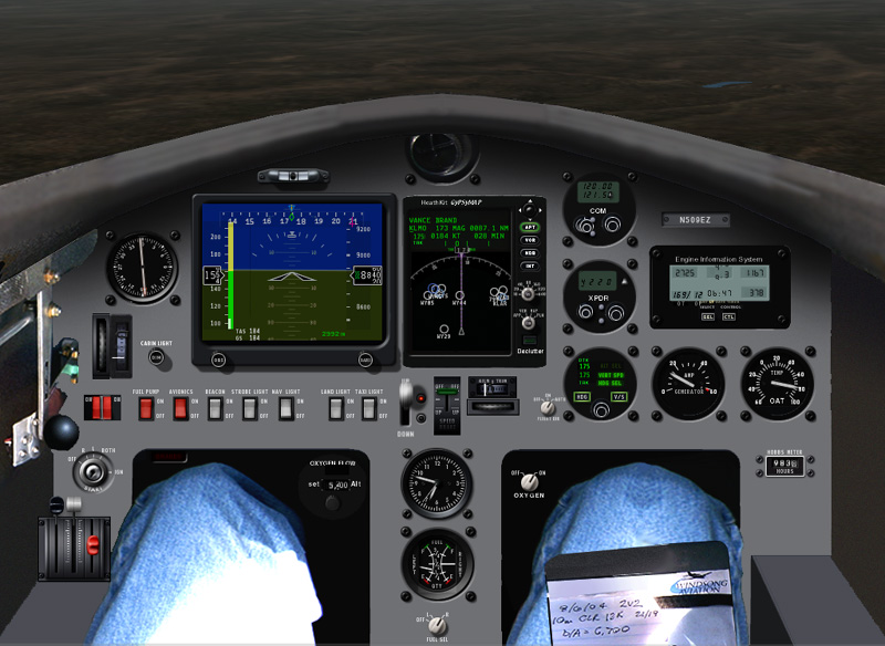

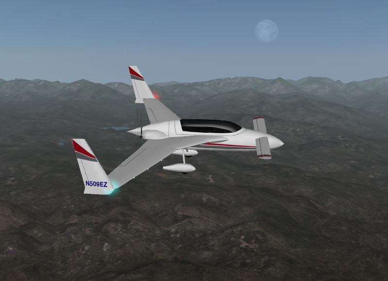

Strider Posted June 27, 2009 Share Posted June 27, 2009 Here is a download link for a Long-EZ in X-Plane version 9. This has been tested in v9.21 and should work well in v9.22 and the v9.30 betas. I'll update it again if required when v9.30 goes final-release. Lyc. O-320 150 HP carbureted; Empty wt. 825 Lbs. Custom artwork for EFIS, GPS, EIS, radios and simple autopilot. Takeoff Vr is 71 KIAS; Full-aft-stick speed is 58 KIAS with a rapid pitch buck; Top speed is 212 MPH true (185 KTAS) at 9,500 MSL drawing 9.2 GPH RoP and 385 F CHT. For best results set Stick response to fully non-linear in Settings/Joystick & Equipment/Centering in X-Plane. Please read the included text file. http://www.vigilanceaero.com/LongEZ_320_921.zip http://www.vigilanceaero.com/Long-EZ_921_air.jpg http://www.vigilanceaero.com/Long-EZ_921_pnl.jpg Updated O-200 VariEze and IO-360 Cozy MkIV are in process. Interestingly, the VEZ and the Cozy do not have the rapid pitch buck of the Long, but demonstrate slow, gentle pitch buck. Hmmm ... Sorry for the long delay. Quote Link to comment Share on other sites More sharing options...
